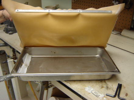

I posted the other day looking for advice on constructing a flip top vac system and you responded with some good advice. Just thought I'd share a picture someone sent me of a system used for building and repairs prosthetic devices. He said it was built from an aluminum cake pan. Amazing what a little bit of ingenuity can do.

Love the cakepan! I am a big fan of doing the minimum possible on jigs, using them, and then improving as necessary. If it works - use it.
